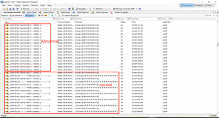

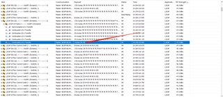

nrf52832 receive data from app, communication by L2CAP, I want to increase throughput to 40kBps.
Now the iphone 8/xr can reach, but iphone 11/12 only 28kBps

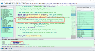

1: Can I increase throughput by increase L2CAP Credit? How can I increase credit?  I try this define "#define BLE_L2CAP_CREDITS_DEFAULT (1)", but it seems no useful.

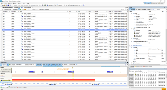

2: Iphone 8 can reach 40kBps, Why iphone 11/12 can't reach? I found there many abnormal communication. The btt file is the log of communication.
#define MAX_ALLOCATED_OBJECT_SIZE 2048
#define L2CAP_RX_MPS      2048
#define L2CAP_TX_MPS      40
#define L2CAP_RX_MTU      2048
