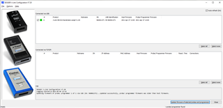

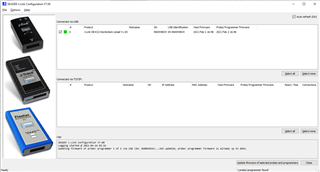

  • I talked to a colleague internally, who's been working on a bug with the Segger UART. A jlink OB fw that includes a fix for this bug will get released soon. I'll keep you updated. Hopefully this is related to the issue you're exeperiencing
  • J-Link v7.20a should include fix for issues related to UART HWFC on nRF91-DK, nRF53-DK, and other K22-based DKs. Could you test that out? https://www.segger.com/downloads/jlink/#J-LinkSoftwareAndDocumentationPack
    Download J-Link v7.20a, open the Configurator tool, connect the kit and click on "update firmware", and the fix will be applied?

  • Not fixed in 7.20a.
    By default KiTTY was using Flow control: XON/XOFF, I also tried RTS/CTS, and OFF. Either way the nRF9160 and nRF52840 terminals start dropping bytes or stops receiving any data.
    Meanwhile the BLE client still receives data even though the USB UART does not: nRF9160 UART1 → nRF52840 UART0 → BLE, and USB UART. Resetting nRF9160 and nRF52840 makes no difference, hence I would look for issues with either of them. We and Segger should focus on fixing the board controller.
