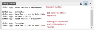

Hello Everyone,
I am using NRF52840 with Custom board, SES v5.20, SDK 15.1.0, IONIC android App(as Central)
1)My problem is, our nrf52840 board will restart once after successful BLE connection then again it will connect and then no restart just work normal and fine and the reset reason will be 4
2)and also controller restart suddenly(not every time, only sometimes) when i do clear data in my android application on that time also we get reset reason 4 only.

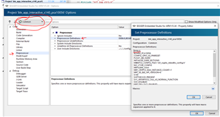

    Most likely, it is the application error handler that triggers the reset. Can you try to add DEBUG to your preprocessor definitions? It looks like you are using Segger Embedded Studio, is that correct?
    If so, you will find your preprocessor definitions here:
    (Note the "Common" selected from the drop down menu).
    After you set this, the error handler shouldn't reset, but rather print some error reason in the log. Can you test this and see if the log says anything right before you would normally see the reset?

    --> i have tried adding debugging in the preprocessor definitions but no use.

  • There are couple of NVIC_SystemReset() added into your main.c file. They are the reason for the resets on your device. Look at the snapshot of the debugging window that i started using your project.
    Why did you add those resets?
