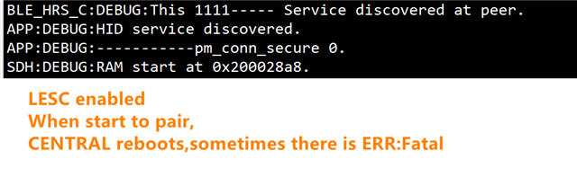

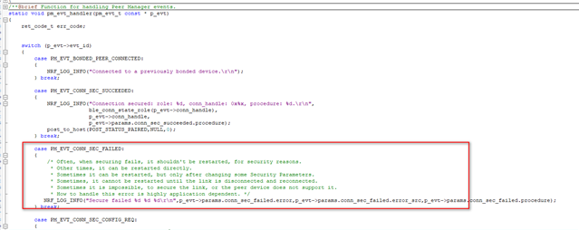

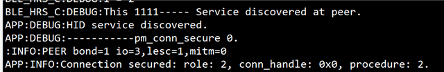

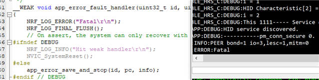

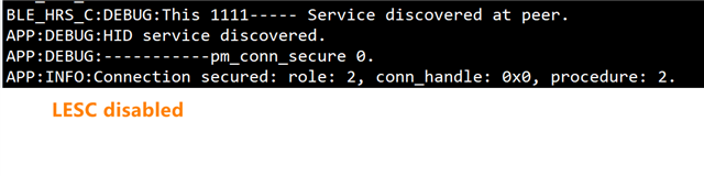

I'm developing a CENTRAL using 52832 to connect a earphone.
1.When I enable LESC, the pair fails with the AUTH_NOT_SUPP error. Why ?
What I think if the earphone doesn't support LESC, legacy pair will take place, pair should still complete.
2.When CENTRAL disconnects from a bounded connection and erased the bond info(earphone still keep the bond info), it cannot make the connection again. There will be error=0x3e immediately happens on every connect attempt.
How to modify to CENTRAL code to adapt this case. When I use phone APP nRF Connect, there is no such problem.
