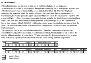

I start to work on the NRF52840 and I would like to read register of BMA400 in burst mode (I mean possibility to read further register in one sequence)
I am novice in C language :-)
Currently, I can read a register but only one
I use the following function to do it

I don't know how to perform a burst mode by using this function.Below an extract of the datasheet of the BMA in order to be clear :-)

    I think the problem is that you are currently passing length=1 to nrf_drv_twi_rx(), which tells the driver to only receive one byte. I suggest you try to define 'data' as an array instead. The size of the array should reflect the number bytes you expect to receive in response to the command you are sending.
    uint8_t data [<number of bytes you expect to receive>];

    I tried to use an array as you propose to me, but it doesn't work.
    I think that my current function I2CReagReg8 doesn't respect the datasheet of BMA400 or BNO055 (see extract on my frist post). This function is done only to read one register.
    As shown on the datasheet, I need a function to perform a multiple read in one sequence.
    I just start to program in C. I am surprised to see that there is not already a function to perform that. It is used on BNO055, BMA400 and I think more others. I found many programs to read values of sensors, but they do a loop, so it is not a multiple read in one sequence, but multiple sequence to read n registers.

    I checked my program and it seems to work now. Actually, I have no logic analyzer so I can't check that I am in burst mode . Below is my program
        ret_code_t err_code;
        uint8_t sample_data;
        uint8_t nSlaveAddr;
        uint8_t nRegAddr_L;
        uint8_t nRegAddr_M;
        uint16_t Acc_X;
        uint16_t Acc_Y;
        uint16_t Acc_Z;
        nRegAddr_L = 0x04;
        nSlaveAddr = BMA400_I2C_ADDRESS;
        uint8_t data[6]; // `data` will store the register data
        err_code = nrf_drv_twi_tx(&m_twi, nSlaveAddr, &nRegAddr_L, sizeof(nRegAddr_L), true);
        if (NRF_SUCCESS == err_code)
           err_code = nrf_drv_twi_rx(&m_twi, nSlaveAddr, &data, sizeof(data));
        Acc_X = (data[1] << 8) + data[0];
        Acc_Y = (data[3] << 8) + data[2];
        Acc_Z = (data[5] << 8) + data[4];
