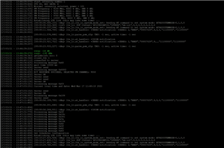

The nRF9160 datasheet V2.0 claims the sensitivity is: CATM=-108dBm (mid band); NBIOT=-114dBm (mid band).
However when the unit connects, we get a printout for the RSRP=-130dBm
How could we get this number for the RSRP if we are below the sensitivity limit?
Please see attached image – the text in GREEN
