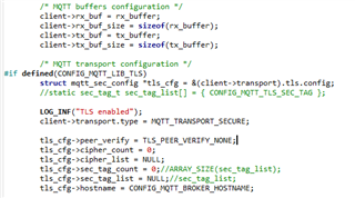

	struct mqtt_sec_config *tls_cfg = &(client->transport).tls.config;
	static sec_tag_t sec_tag_list[] = { CONFIG_MQTT_TLS_SEC_TAG };
	LOG_INF("TLS enabled");
	client->transport.type = MQTT_TRANSPORT_SECURE;
	tls_cfg->peer_verify = TLS_PEER_VERIFY_NONE;
	tls_cfg->cipher_count = 0;
	tls_cfg->cipher_list = NULL;
	tls_cfg->sec_tag_count = 0;
	tls_cfg->sec_tag_list = NULL;
	tls_cfg->hostname = CONFIG_MQTT_BROKER_HOSTNAME;
	tls_cfg->session_cache = IS_ENABLED(CONFIG_MQTT_TLS_SESSION_CACHING) ?
					    TLS_SESSION_CACHE_ENABLED :
					    TLS_SESSION_CACHE_DISABLED;
	return err;

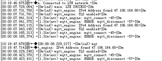

    I changed to another 91 chip and burned the same program. -45 error occurred in mqtt connection : Operation not supported on socket. Here is my log:
    [00:00:00.243,316] <inf> main: Connecting to LTE network.
    [00:00:00.243,316] <inf> main: This may take several minutes.
    [00:00:00.243,377] <inf> flash_control: No apn found, use default apn
    [00:00:00.249,908] <inf> main: Set to the default APN CMNBIOT2.
    [00:00:00.258,087] <inf> lte_lc: Using legacy LTE PCO mode...
    [18:48:48.897]收←◆[00:00:01.725,158] <inf> mai
    [18:48:48.919]收←◆n: LTE ERROR
    [00:00:02.258,117] <inf> main: CSCON : 1
    [18:48:50.833]收←◆[00:00:04.283,386] <inf> main: Connected to LTE network.
    [00:00:04.283,477] <inf> main: LTE SUCCESS
    [00:00:04.286,163] <inf> mqtt_engine: IPv4 Address found 47.106.164.80
    [00:00:04.286,193] <inf> mqtt_engine: TLS enabled
    [00:00:04.286,468] <dbg> net_mqtt_sock_tls.mqtt_client_tls_connect: (0x20015220): Created socket 1
    [00:00:04.660,552] <err> mqtt_engine: mqtt_connect -45
    [00:00:04.660,583] <err> mqtt_engine: ERROR: mqtt_disconnect -57
    -45 is EOPNOTSUPP, and typically indicates that you have written wrong certificates to the device. But I had peer_verify set to 0.

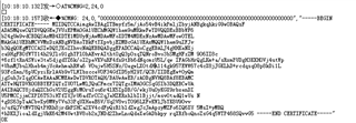

  • Hi again,
    the modem trace you provide does not contain the necessary information about the connection attempt.
    "Modem trace is only 15 seconds long and contains 2 DNS queries sent by application. Not a sign for TLS connection establishment. Signal level seems to be in good level."
    It would be nice if you could take a new trace and get all the details from the connection attempt.
  • int mqtt_client_tls_connect(struct mqtt_client *client)
    	const struct sockaddr *broker = client->broker;
    	struct mqtt_sec_config *tls_config = &client->transport.tls.config;
    	int ret;
    	client->transport.tls.sock = zsock_socket(broker->sa_family,
    						  SOCK_STREAM, IPPROTO_TLS_1_2);
    	if (client->transport.tls.sock < 0) {
    		return -errno;
    	MQTT_TRC("Created socket %d", client->transport.tls.sock);
    #if defined(CONFIG_SOCKS)
    	if (client->transport.proxy.addrlen != 0) {
    		ret = setsockopt(client->transport.tls.sock,
    				 SOL_SOCKET, SO_SOCKS5,
    				 &client->transport.proxy.addr,
    				 client->transport.proxy.addrlen);
    		if (ret < 0) {
    			return -errno;
    	/* Set secure socket options. */
    	ret = zsock_setsockopt(client->transport.tls.sock, SOL_TLS, TLS_PEER_VERIFY,
    			       &tls_config->peer_verify,
    			       sizeof(tls_config->peer_verify));
    	if (ret < 0) {
    		goto error;
    	if (tls_config->cipher_list != NULL && tls_config->cipher_count > 0) {
    				       TLS_CIPHERSUITE_LIST, tls_config->cipher_list,
    				       sizeof(int) * tls_config->cipher_count);
    		if (ret < 0) {
    			goto error;
    	if (tls_config->sec_tag_list != NULL && tls_config->sec_tag_count > 0) {
    				       TLS_SEC_TAG_LIST, tls_config->sec_tag_list,
    				       sizeof(sec_tag_t) * tls_config->sec_tag_count);
    		if (ret < 0) {
    			goto error;
    	if (tls_config->hostname) {
    				       TLS_HOSTNAME, tls_config->hostname,
    				       strlen(tls_config->hostname));
    		if (ret < 0) {
    			goto error;
    	if (tls_config->session_cache == TLS_SESSION_CACHE_ENABLED) {
    				       TLS_SESSION_CACHE,
    				       &tls_config->session_cache,
    				       sizeof(tls_config->session_cache));
    		if (ret < 0) {
    			goto error;
    	size_t peer_addr_size = sizeof(struct sockaddr_in6);
    	if (broker->sa_family == AF_INET) {
    		peer_addr_size = sizeof(struct sockaddr_in);
    	ret = zsock_connect(client->transport.tls.sock, client->broker,
    			    peer_addr_size);
    	if (ret < 0) {
    		goto error;
    	MQTT_TRC("Connect completed");
    	return 0;
    error:
    	(void) zsock_close(client->transport.tls.sock);
    	return -errno;
    The problem lies in the zsock_connect() function on line 77.
    Finally, through breakpoint debugging, it is found that the nrf_modem_os_errno_set() function in the nrf_modem_os.c file will set errno = EOPNOTSUPP
    What is the reason for errno = -45?
     It is usually a certificate issue. The best to know for sure is to do a proper modem trace to get the details from the TLS handshake.
  • I think this is a SDK bug, not a modem firmware problem. I reacquired the modem trace.trace-2021-04-28T02-21-08.402Z.bin
    This is a demo.6661.mqtt_simple_test.rar
