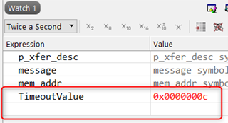

I am using nRF52840 as a bare-metal with SDK17.02 along with Segger Embedded Studio for ARM v5.20a for development.
I am trying to create a sample timer using app_timer and trying to capture the timeout after set tickcount.
below are the things done
Creating timer
APP_TIMER_DEF(m_conn_int_timer_id);
uint32_t TimeoutValue = 0;
Initializing and starting the timer
nRet = app_timer_create(&m_conn_int_timer_id, APP_TIMER_MODE_REPEATED, connection_interval_timeout_handler);
nRet = app_timer_start(m_conn_int_timer_id, APP_TIMER_TICKS(1000), NULL);
Timer handler
static void connection_interval_timeout_handler(void * p_context)
  UNUSED_PARAMETER(p_context);
  TimeoutValue++;
after starting the timer I enter a while loop and intend to break after TimeoutValue >10 with below logic
while(1)
    if(TimeoutValue >= 10)  break;
app_timer_stop(m_conn_int_timer_id);
Now refer to the attached image. I use J-link to debug and flash. While debugging the loop doesn't break, in fact the TimeoutValue keeps increasing 11,12,13..... and so on.
And after some point I enter NRF_BREAKPOINT_COND; and cannot continue further.
If I flash and run the program it neither crashes nor breaks the loop.
I would like to know what could be going wrong here. I don't know what to suspect SES studio or nrf or j-link.

Incase the above image size is reduced,
the loop where I hit the breakpoints
The value at the time of hitting breakpoint
