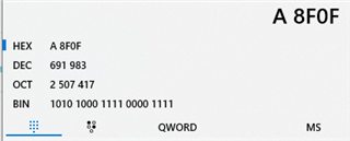

I am getting the Proper MCC & MNC values where as I am getting the cellID as different to which I am getting in LTE link monitor
expected:-
Cell ID: 691983, Tracking area: 49235
but what i am receiving is CELLID 000A8F0F, AREA CODE C053
Can you please help me out how to get the expected cellID & lac
