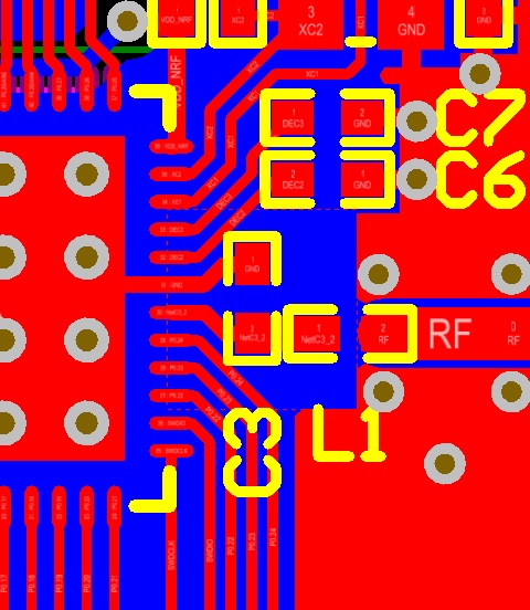

I have two questions about nRF52832 QFAA Custom PCB.
1)
When I calculate load capacitance for external crystal.
Is this fomula(C1,C2 =2Cl - Cstray {Cstray = 4pF}) correct??
2) I know C6(=DEC2) in nrf52832 QFAA reference circuiry.
And DEC2 should be floated.
So can I leave DEC2 pin like this picture??
