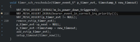

The node sends a message to the provisoner whenever the node resets (using the function access_mode_publish() in access.c). No messages are send until the subscription address is set (which is correct). But after I set the application key and subscription address with the nrf mesh app, the program gets an assert when it sends the message. It goes to the error handler.
(I've tested this in nrf sdk for mesh v4.2.0 and v3.0.0 as well, but I get the same problem).
I have been debugging this problem and I found out that the assert happens in the timer_scheduler.c here:
If I'm correct, this means that an irq priority is not set correctly. But I have set all irq priorities to 6 (NRF_MESH_IRQ_PRIORITY_LOWEST), so I don't know why this gives the problem.
I've been looking in the migration guides and release notes, but I couldn't find anything that could help me with this problem.
So my question is: How can I solve this irq priority problem?

    I asked one of our developers about this. This is his response:
    I guess when the they are trying to publish a message, but the function is called from the wrong IRQ priority. Any mesh API after mesh is started must be called from the same priority as configured through mesh_stack_init_params_t.core.irq_priority. As a simple check they could use bearer_event_generic_post to schedule a callback at the mesh IRQ priority and publish a message from this callback.
    Can you try this and see if it helps?

    This is what i tried:
    void(*callback)(bearer_event_callback_t) = &my_cb;
    bearer_event_generic_post(callback, NULL);
    void my_cb() {
        /* publish the message */
    My message is now publish without errors/asserts.
    Note: I changed the mesh_stack_init_params_t.core.irq_priority back to NRF_MESH_IRQ_PRIORITY_LOWEST (6), otherwise I cannot connect to my nrf.
    I will do some more tests and verify if the message is also received correctly. It looks promosing.
