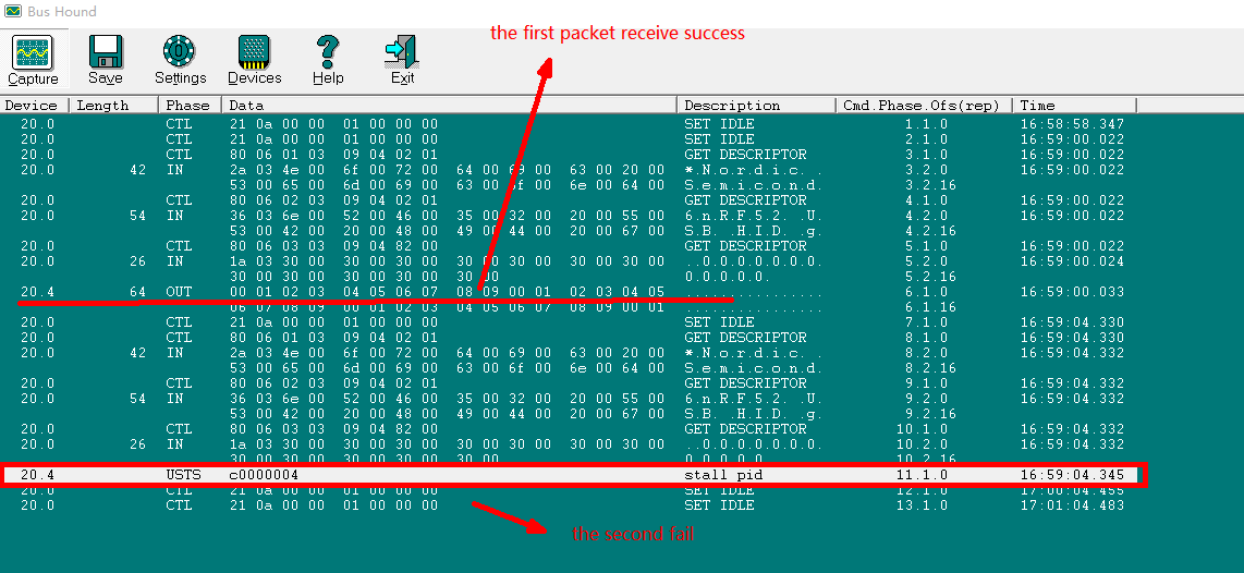

  • Thanks for you reply,I ran into another problem。The first packet of data sent by the PC was successfully received, and the second packet of data failed to be received。
    The packet capture tool shows that the second packet of data was unsuccessful, and the device entered the stall pid.
     Function returns  failed  in  p_ep_conf->event_handler() function ( in app_usbd.c)

    Please tell me how to solve this problem.
