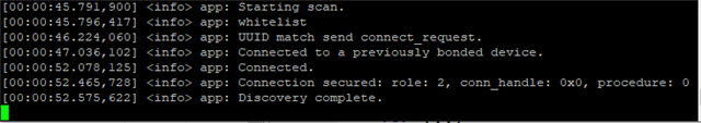

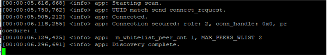

    Ok, i will try to explain it even further. I am trying to connect two nrf52832 chips and pair them. First, i scan without whitelist and the two devices connect and pair in like 500 ms.
    Then, I disconnect the device and start advertising in the peripheral and scanning in central, both using whitelist (which contains the information of previously bonded device). The pairing of this takes around 5sec. Why is it that this is slower than the first one is my question?
    In other words once I call sd_ble_gap_connect(), it takes more time while connecting to a device with whitelist enabled than a device without whitelist enabled.

  • 2. Okay, I didn't realize this was about the re-connection taking too long. Thank you for explaining. Can you confirm whether it is the time from the DISCONNECTED to CONNNECTED events or from the CONNECTED event until the devices are paired again that takes ~5 seconds by debugging? How do you handle the  BLE_GAP_EVT_DISCONNECTED event for instance?

  • Can you confirm whether it is the time from the DISCONNECTED to CONNNECTED events or from the CONNECTED event until the devices are paired again that takes ~5 seconds by debugging?
    Time taken is from the time I get BLE_adv_report and if the UUID match request does match to the time I get connection secured event. Basically if UUIDs match I call connect request, from that time till I get connection secured event. I call pm_conn_secure once I receive the BLE_GAP_connected event.

  • Okay, this seems to take a bit too long then, do you have a debug log with timestamps or maybe you can take a sniffer trace so we can get some details as to what exactly is taking time in this process? If you have an nRF52 DK you can use it as a sniffer with the nRF Sniffer firmware and Wireshark for example.
