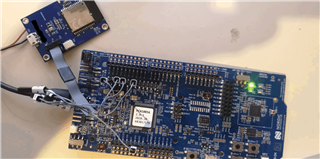

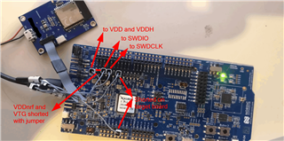

I am trying to program an extrnal nrf52840 it is Minew MS88SF2, I did exactly as desribed here at least I think I did, but unfortunatly it always programs the internal NRF. I measured power supply voltage on external NRF and double cheked connections with multimeter it seems OK. I am using Mbed Studio.
Do you have any suggestions what else can I try?
Thank you very much.
Also I should mention I am able to program board using J-link EDU mini and NRF connect.
