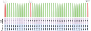

  • Please note that the frequency for channels 37, 38, and 39 are not 2437, 2438, and 2439. The BLE system operates on 40 channels from 2402 to 2480 each being 2MHz wide. The advertising channels are strategically placed at these values to avoid interference from each other and other devices operating in the same spectrum.
    I would suggest using the nrf_radio_frequency_set if you'd like to advertise on one specific frequency, but writing straight to the registers should work as well. The frequency for channel 37 would be 2402MHz.

  • What I've seen from the nrf_radio_frequency_set function, it sets the RF_RADIO->FREQUENCY register to a delta value of the provided frequency minus 2400.
    If I provide 2480 for Channel 39 the register is set to 80.
    Would this mean if I want to set the register directly, I'd have to write  the following values to the register to set it to channel  39 or channel 37?
    RF_RADIO->FREQUENCY = 80u; //Channel 39
    RF_RADIO->FREQUENCY = 2u;  //Channel 37
