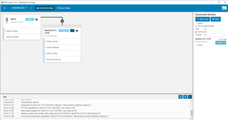

  • Dear Hung Bui,
    Follow your questions,
    What exactly happened when you try to do DFU ?  - Please see below:
    When I open the BLE nRF connect it's looking OK.
    Choosing my board
    I have already selected the SDK nRF52840-DK and still looking OK

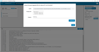

    Choosing  the DFU file and click "Start DFU"
    And after a few seconds got a white screen:
    Or sometimes got the next note:
    Which SDK your bootloader based on ?  - nRF52840-DK
    If you flash and test the stock bootloader from the SDK would it work ?  - Sorry, please explain it...
    Have you tested if a normal BLE application still works on those board ? Yes! the BLE is working properly with our application.
    Please try capture a sniffer trace when you do DFU update. You would need  an extra nRF52/dongle to be used as the sniffer.
    From what you described, it seems that the nRF Connect app couldn't write the command to your application to switch to bootloader mode.
    Please check if you have any assert/crash on your device when testing. Please check if you have any log.
    Please let us know which SDK you based your application& bootloader, I know you use the DK, but the SDK is the software development kit that you based your application on.
    To flash a stock bootloader, just go to the SDK that you use and try compiling and flash the bootloader (\examples\dfu\secure_bootloader)  firmware to test.
