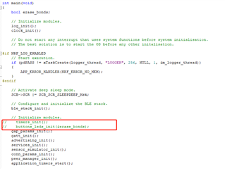

I run ble_app_hrs freertos on PCA10056 DK board and cannot enter low power consumption.

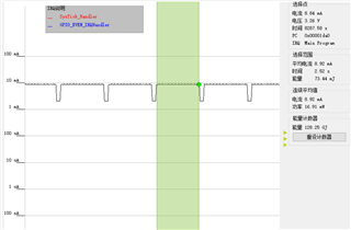

Do I need special settings to use freertos to enter low power consumption? The following are my test conditions: 1. Use SDK17\examples\ble_peripheral\ble_app_hrs_freertos example. 2. Comment out timers_init(); and buttons_leds_init(&erase_bonds); 3. Compile the routine and burn it into PCA10056 DK. 4. Use a current measuring instrument to test the current waveform as follows
