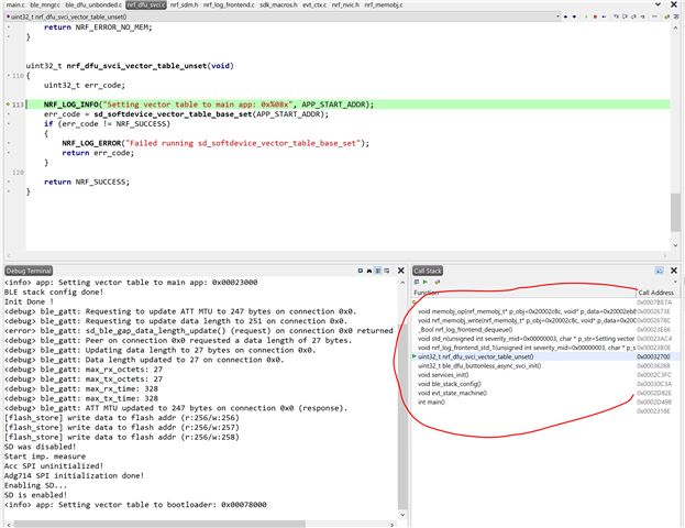

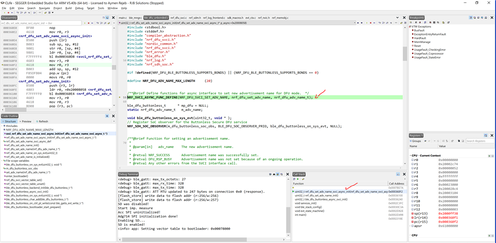

    Thank you for your quick reply, I'm using bootloader_secure_ble example in SDK 14.2.0
    Now, I was trying to reproduce the same behavior that I mentioned in my question, but what I get is a weird behavior:
    The nrf_dfu_set_adv_name_init sometimes returns NRF_SUCCESS:
    and then application is hanging at the first instruction in the nrf_dfu_svci_vector_table_unset at NRF_LOG_INFO and does not return! and still blocked at __sd_nvic_irq_enable():
    And sometime is still blocked at a different instruction! and sometime is works fine!
    I tried to comment out the call the NRF_LOG_INFO in the nrf_dfu_svci_vector_table_unset function (as it is 90% failing at this level), the application still hanging at nrf_dfu_set_adv_name_init and don't return, it still blocked:
    So as you can see once the nrf_dfu_set_adv_name_init is getting executed (after disabling and enabling again the softdevice) I start having a weird behavior!
    I'm start wondering if it is not an issue related to interrupts enable/disable between the applicaton, bootloader
     and softdevice?
