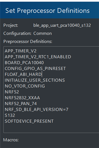

I am creating a saadc project based on the ble_app_uart project.
The source code is as follows.

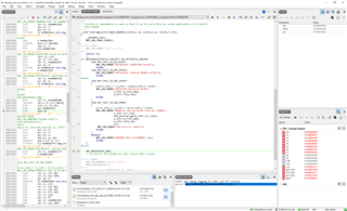

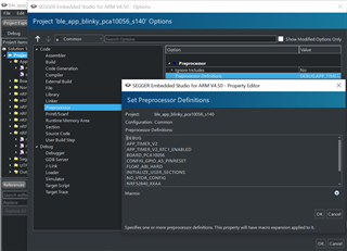

If you download after compiling, the following operation is performed.
The problem arises from the occurrence of the saadc_sampling_event_init function.
