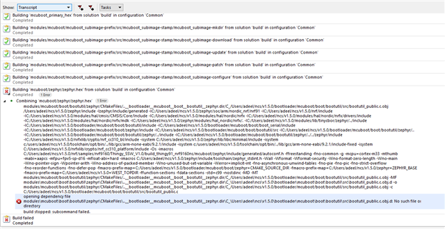

I also uploaded the (app_update.bin) file of the program I want to update in the Upload Bundles section in the NRF Cloud.
I compiled and ran the program and the NRF Cloud gets connected through MQTT, but it does not download the file that I have uploaded in the NRF Cloud.
