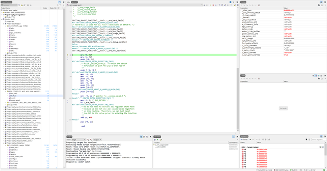

Custom board, ncs v1.4.0, modem FW v1.2.3, SES v5.34a. The code is based on the Asset Tracker (v1), LTE with PSM, motion-activated GPS, using MQTT to send messages to private backend.
I'm having some random reboot issues.  I set a breakpoint on sys_reboot() in reboot.c to see how we got there.  I hit Go and when it stops, the Debugger has stopped on a spurious fault, which would lead to a reboot.  There's nothing helpful in the call stack.  It’s quite intermittent.  So far, it has happened right after an MQTT Subscribe and then I see it during a GPS restart.  Any ideas on how to debug this?

     If you step a bit further through the fault handler, it should eventually give you more information.
    In addition, setting CONFIG_RESET_ON_FATAL_ERROR=n and CONFIG_LOG=y should make the fault handler print out an error message.
    CONFIG_LOG_IMMEDIATE=y can be used to disable deferred logging, so that all log messages gets printed where they are in the code. That way, you will not miss any yet-to-be-printed log messages.
    Remember that you have to use 'Project -> Run CMake...' or re-open the project for changes to prj.conf or other configuration files to take effect when using SES.
