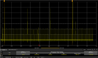

    Here's how the PSM current should look like (running the UDP sample from NCS):
    Use 250 ms/div and 512k sampling points to get the best resolution (5us) (if you choose to capture using the scope function, not data logger). Click on the "Ranges..." button and make sure that the channel is set to "Current: Auto"
    If you still see 0.7 uA in PSM, can you measure the floor current between the regulator refresh spikes (all the spikes you see in the plot above are from the internal regulator). It should be around 1 uA. If you see less or a negative value, I'm thinking that the 91 is powered from something externally. Not sure what that could be. What is the DK version? I can try the exact same setup here

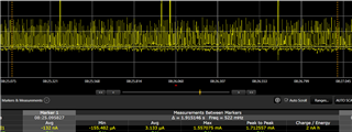

  • So that definitely helped, I'm now seeing 3.1uA with the UDP example (serial disabled). This seems a little high though, as yours is showing 2.7uA:
