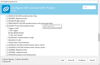

Running the Zephyr LIS2DH sample program on a custom board works fine until I configure it to use the trigger and then it throws the z_arm_mpu_fault() error. It doesn't matter if I have it use it's own thread or the global thread.
Any idea what could be causing this?

  • I made the following change:
    CONFIG_MAIN_STACK_SIZE=8192
    I have the debugger stopping on the first line of main.c but it dies before then.
    I was able to get more data this time:
