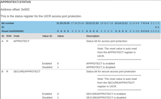

2. Option (using the SWD protocol)
in this example we use the Jlink on board to access the CTRL-AP
Open up "J-Link commander"
Use command "?" to see full list of optional commands.
SWDSelect // Activate SWD SWDWriteDP 1 0x50000000 // Enable debug power SWDWriteDP 2 0x04000000 // Selects the 0x04XXXXXX Access Port and 0xXXXX00XX Register bank in the access port SWDReadAP 3 // CTRL-AP Bank 0, register offset 3 (APPROTECTSTATUS 0x00C): Access port protection status SWDReadAP 3 // //Second read returns the value: 0: enabled 1: not enabled
So here you can see I get:
0x00000003
and that is
0000 0000 0000 0000 0000 0000 0000 0011
in binary, so we can see from the APPROTECT.STATUS that both APPROTECT and SECUREPROTECT is disabled:
