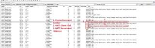

    I agree with most of that. What about a read characteristic from Central, would not that generate a transmission in the Peripheral?
    Assume that Application has queued a single notification, and Central happens to also want to read a particular READABLE characteristic from the Peripheral. On the next connection interval, wouldn't that  generate possibly two transmissions?
    #1 for the Notification we have queued
    #2 to read the characteristic that Central was interested in reading
