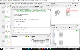

complicated problem in sdk17.0.2 interactive command uart rx/tx output buffer
so Im tring to use interactive command to output my personal content

same as the device command which out put the device  message
but i want to find the function which  put all the  character into a buffer before it output to the uart
also want to know when did the code call the Uart I only found

but i did not find anything which it called the Uart  when it output the string
anyone knows?
the reason why om doing this is because i  want to set the uart rx by myself to connect other device
i found  out p_io_buffer is the buffer which send the message but there are no function later on how did it send?
and i found out after the write command it bump into the function under but how? when did this fuction been called
void nrf_cli_print_stream(void const * p_user_ctx, char const * p_data, size_t data_len)
    cli_write((nrf_cli_t const *)p_user_ctx,
              p_data,
              data_len,
              NULL);
