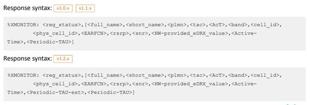

    Also please note that there are both periodic TAU (T3412) and extended periodic TAU (T3412ext), and +CEREG will only give you the extended periodic TAU value. To see the periodic TAU value that the network has set, you have to use %XMONITOR (and mfw >=1.2.0).

  • Hi, from the return of %XMONITOR, it doesn't look like you are using MFW v.1.2.0 or higher.
    The periodic TAU returned from %XMONITOR with MFW < 1.2.0 is the extended timer value. If possible, update the MFW and run the command again.

    AT%XMONITOR
    %XMONITOR: 1,"","","22201","9129",9,20,"0AAE9CA1",437,6290,15,19,"","00011110","11100000","01001001"
    OK
    I see that the periodic-tau set with +CPSMS ("10101010") is different from the one obtained with %XMONITOR ("01001001").
