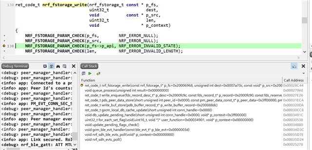

DK is a peripheral connected to many centrals. Every time I connect to a phone I get the messages attached in the picture.. My question: Is flash actually written every time a connection is established? message: "<info> peer_manager_handler: Peer data updated in flash: peer_id: 0, data_id: Local database, action: Update" I also use a workaround from nordic that checks if there is no change in CCCD and skips writing again. Message "Local db is up to date". I have also noticed with debug that there is a call in "nrf_fstorage_write(....) function. If flash is written over and over again when connected I am afraid it will be destoyed

    Try to set a breakpoint inside nrf_fstorage_write() to check the call stack to see where it is written from.
    I don't see any decision made by gscm_service_changed_ind_needed() that will trigger a flash directly, but it may be something using these flags (ble_conn_state_user_flag_set) to determine whether or not it needs to write to flash.

    Anyway you are right. The gscm_service_changed_ind_needed() does not trigger a flash write. If I set a breakpoint in nrf_fstorage_write() in the picture you can see the call stack. I still can't figure out what is triggering the write.
    I also noticed that in the PM_EVT_PEER_DATA_UPDATE_SUCCEEDED event ,p_evt->params.peer_data_update_succeeded.data_id = PM_PEER_DATA_ID_GATT_LOCAL with action PM_PEER_DATA_OP_UPDATE.

    After further investigation the flash write is triggered here
            case BLE_GATTS_EVT_WRITE:
                /* Skip local db update if new CCCD setting is identical to the previous one */
                if (cccd_written(&p_ble_evt->evt.gatts_evt.params.write) &&
                   (local_db_needs_update(conn_handle)))
                    local_db_update(conn_handle, true);
                    update_pending_flags_check();
    in the gatt_cashe_manager.c file where the peer's data are different from locals data base. So I guess the stack works as expected. Now why peer data are not the same is something else. I use a custom nus service with tx and Rx characteristics to send receive data to/from peer
  • Ok, so it is the pds_peer_data_store() that stores the data in flash, and in your case it is called from write_buf_store() called from gscm_local_db_chache_update() (I am just reading this from your call stack), called from db_update_pending_handle(), and so on. This all comes from the gcm_ble_evt_handler() in gatt_chache_manager() which calls update_pending_flags_check(). Try setting a breakpoint to determine whether or not it comes from the BLE_GATTS_EVT_WRITE event. If so, is this event caused by the central enabling notifications on one of the services? Have you tried commenting out this call to update_pending_flags_check() just to see how it behaves and if this is the one causing the updates.
