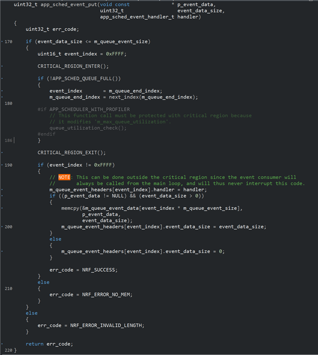

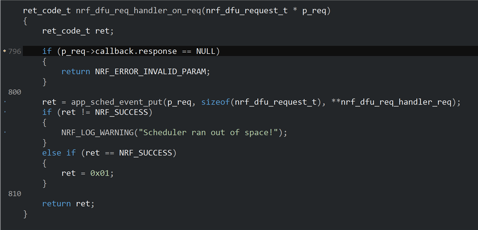

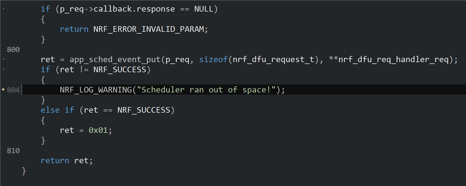

App Scheduling Error for SPI DFU
 I am currently running a custom bootloader I found that updates via SPI. I have 2 nrf52840 DKs that are programmed as an SPI master and a SPI bootloader. I have been following this link to help with understanding how the devices should communicate. I have been able to get up to the point where the code should now be writing to the target device. I can confirm that the target device is getting the data it should be writing, however, it always shoots a "Failure to run packet write" error. The dfu code is shown below and the place where the error happen can be seen in line 279.

Using the debugger and stepping into line 276, I was able to find the internal error with the app_scheduler_event_put() function in the app_scheduler.c file outputting NRF_ERROR_NO_MEM error. In my nrf_bootloader.c I have the scheduler initialized as:
#define SCHED_QUEUE_SIZE      129         /**< Maximum number of events in the scheduler queue. */
#define SCHED_EVENT_DATA_SIZE NRF_DFU_SCHED_EVENT_DATA_SIZE /**< Maximum app_scheduler event size. */
//NRF_DFU_SCHED_EVENT_DATA_SIZE = (sizeof(nrf_dfu_request_t)) = 24
/**@brief Function for initializing the event scheduler.
static void scheduler_init(void)
    APP_SCHED_INIT(SCHED_EVENT_DATA_SIZE, SCHED_QUEUE_SIZE);
If anyone has any ideas as to how I should fix this error, I would greatly appreciate it!!!
  • Seems like you are putting events in the sched queue faster than you can pull.
    Try increasing SCHED_QUEUE_SIZE to a value that suits your application needs.
  • I have increased the value from as high as 4096 and yet I still get the same error.
  • there is no other reason this function would fail with that error reason. Can you pinpoint inside app_scheduler_event_put where exactly (line number) it fails with this error?
  • I don't know exactly where it fails since the debugger completely skips it when I do the step debug. In the first picture, I am going into nrf_dfu_req_handler_on_req function where app_sched_event_put was being called.
    When I go into the next step, it skips all the way to the second picture, which is how I know that there is an error coming from that function.
    I was able to go to the definition of app_sched_event_put and be able to hover over some of the variables to see their values, most did not give me a value like the event_index, but err_code = 0x04 which is the same value as NRF_ERROR_NO_MEM.
    Going back to the nrf_dfu_req_handler_on_req function in the first and second picture, I hovered over callback.response variable and found that it equals 0, meaning that it should show the NRF_ERROR_INVALID_PARAM, but it didn't. None of these errors pop up in the debug terminal, only when I step into them can I see them.

     This is probably because you are compiling your project with optimizations? Please remove the optimizations (set them to 0) so that the debugger includes a lot of debug symbol info the elf file for a better debugging experience.
    One other angle to explore could be that you are receiving the data too fast than your application can handle it, which eventually is causing the app_scheduler fifo to overflow. increasing the buffer in this case might only delay the overflow if the data is too much.
    Also check if yo uare calling app_sched_execute in your bootloader and how often it gets called. What is the status of the shceduler queue when this problem happens? is the scheduler fifo full? you can debug to get this information.
