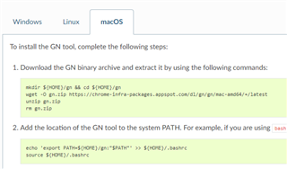

    Regarding the .bashrc issue, the Nordic instructions (in step 2 of the Manual install) would have the user make changes to the .bashrc file. On Linux that would be correct. On the Apple (at least with M1 silicon), those changes should be made in the .bashrc_profile file instead to have effect in the command prompt window when opened.

    Over the last week I managed to install the nRF Connet SDK on a MacBook with the Intel Silicon (returned the Mac with M1 silicon to Apple). The recommended manual toolchain install and Getting Started Assistant failed and would not build the example project due to a "create_nordic_project.py failed (1)" cryptic message. I then used the "experimental" Toolchain Manager to install the SDK and was successful in building the CLI example for nrF52840-DK.
    You may want to add a BOLD note to the MacOS instructions / system requirements that M1 Silicon is NOT supported by Nordic at this time - in order to avoid developers purchasing the wrong Apple MacOS product as I did.
