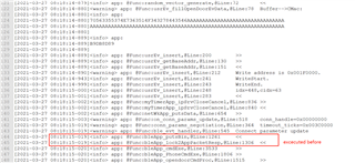

  We found a problem about the NRF52832AA connect parameter update problem on some cell phones.
  1. While the app connect to our device, parameter update not only one time, is this correctly?
  2. I set the NEXT_CONN_PARAMS_UPDATE_DELAY to 30s, but it update parameter after 2.5s sometimes, is this correctly?
  3. While our program run in a scheduler task, the connect parameter update event happened, but it not correctly back to my task procedure and back to the command that ever executed.

    3.I just run the app_scheduler, my task is running in scheduler task in main function, the "connect parameter update" event is trigered(interrupt context) while i communication our cloud server with wifi module(It happens in a very low , about 1 time in 1330 times test when i set broadcast power as -12dbm, and 0 times in 5000 times test when i set broadcast power as 0dbm).

    3. Is the problem that you're getting a "connection paramater update" event in 1 out of 1330 tests? You highlighted some other events in the screenshots you posted.
