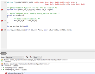

The issue I experience with that is that the project fails on compilation in IDE in my_service.h include file:
The project was fully download as a provided ZIP file and used is it is being unzipped with the required structure
Any chance the zipped project content is missing some file or probably some other info is missing in one of the files ?
Will appreciate any asistance
Alex
  • Well, that was exactly from Nordic project as they go over in that tutorial, did not change anything on my own
    Anyway, thanks a lot for the hint. I did altered that and it turns there are similar issues with 16-bit and 32-bit type declarations used in the files of that tutorial
    Fixed all to your suggested name (along with 16 and 32 respectively) and it works! Thanks a lot!
