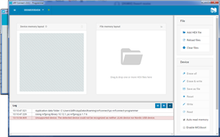

Hello I am trying to program an external custom board that has an NRF52832 on it and I'm using the NRF52840-DK (Development Kit). The programming is being done using SWD over a Tag Connect interface to the Target board and using the NRFConnect Programming tool.
The very first time that I programmed this device was successful without any issue and everything worked great.
For some reason when I attempted it a second time the next day, the NRFConnect Programming utility was giving me this error (see Subject name).
I have since downloaded J-Flash and have successfully connected to the target and Programmed/verified, but for some reason the programmed application does not run when using J-Flash. I know this program runs correctly because It is the initial one that I flashed onto my Target using the NRFConnect, the target NRF52 was then connected to our products App over BLE and everybody was happy.
This all seems like a possible driver issue imo.
Any help appreciated.
NRFConnect LOG:
2021-03-30T21:03:37.477Z INFO Application data folder: C:\Users\billh\AppData\Roaming\nrfconnect\pc-nrfconnect-programmer
2021-03-30T21:03:38.203Z DEBUG App pc-nrfconnect-programmer v1.4.8 official
2021-03-30T21:03:38.204Z DEBUG App path: C:\Users\billh\.nrfconnect-apps\node_modules\pc-nrfconnect-programmer
2021-03-30T21:03:38.205Z DEBUG nRFConnect 3.6.1 is supported by the app (^3.6.0)
2021-03-30T21:03:38.209Z DEBUG nRFConnect path: C:\Users\billh\AppData\Local\Programs\nrfconnect\resources\app.asar
2021-03-30T21:03:38.211Z DEBUG HomeDir: C:\Users\billh
2021-03-30T21:03:38.212Z DEBUG TmpDir: C:\Users\billh\AppData\Local\Temp
2021-03-30T21:03:38.337Z INFO Using nrfjprog library 10.12.1, pc-nrfjprog-js 1.7.6
2021-03-30T21:03:41.588Z ERROR Unsupported device. The detected device could not be recognized as neither JLink device nor Nordic USB device.
2021-03-30T21:03:45.627Z INFO Target device closed.
2021-03-30T21:03:47.014Z ERROR Unsupported device. The detected device could not be recognized as neither JLink device nor Nordic USB device.
