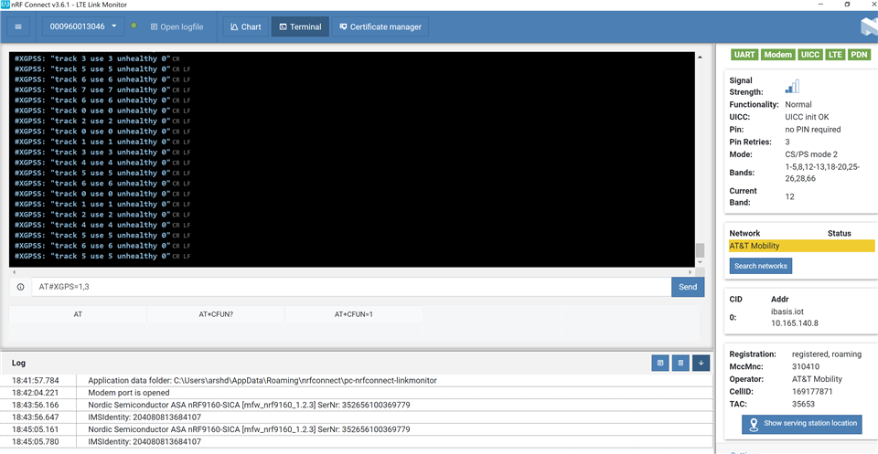

AGPS not locking even after getting enough healthy satellites
Hello Team Nordic,
We are using nrf9160 DK with serial_lte_modem aplication and mfw_nrf9160_1.2.3 modem firmware and TAOGLAS AGPSF.36C UfL antenna .
We want to utilize the AGPS in order to improve our GPS lock time and efficiency. But we are facing some issues with it. Even if we get enough satellites, it does not lock, at least for a long time it doesn't. I have seen it getting locked with same number of satellites coupe of times. But most of the time it fails to get a lock.
I have logs saved with me which I am attaching below. Can you please help me identify what could be going wrong by looking at the logs?
Also, do you have any documentation of the algorithm used to get data from AGPS, like how much data does it take to download the information, how many times does it download the data , power consumption etc??

2021-03-31T01:45:24.629Z DEBUG modem >> AT#XGPS=1,3
2021-03-31T01:45:24.652Z DEBUG modem << #XGPS: 1,3
2021-03-31T01:45:24.655Z DEBUG modem << OK
2021-03-31T01:45:24.660Z DEBUG modem << #XGPSS: "GPS suspended"
2021-03-31T01:45:27.620Z DEBUG modem << #XGPSS: "SUPL injection done"
2021-03-31T01:45:27.634Z DEBUG modem << #XGPSS: "GPS resumed"
2021-03-31T01:45:34.397Z DEBUG modem << #XGPSS: "track 2 use 2 unhealthy 0"
2021-03-31T01:45:38.398Z DEBUG modem << #XGPSS: "track 3 use 3 unhealthy 0"
2021-03-31T01:45:42.398Z DEBUG modem << #XGPSS: "track 4 use 4 unhealthy 0"
2021-03-31T01:45:43.400Z DEBUG modem << #XGPSS: "track 5 use 5 unhealthy 0"
2021-03-31T01:46:26.558Z DEBUG modem << #XGPSS: "track 0 use 0 unhealthy 0"
2021-03-31T01:46:27.933Z DEBUG modem << #XGPSS: "track 4 use 4 unhealthy 0"
2021-03-31T01:46:28.162Z DEBUG modem << %CESQ: 48,2,6,0
2021-03-31T01:46:40.963Z DEBUG modem << %CESQ: 50,2,11,1
2021-03-31T01:46:54.537Z DEBUG modem << #XGPSS: "track 5 use 5 unhealthy 0"
2021-03-31T01:47:00.654Z DEBUG modem << #XGPSS: "track 4 use 4 unhealthy 0"
2021-03-31T01:47:45.737Z DEBUG modem << #XGPSS: "track 5 use 5 unhealthy 0"
2021-03-31T01:47:47.738Z DEBUG modem << #XGPSS: "track 6 use 6 unhealthy 0"
2021-03-31T01:47:53.974Z DEBUG modem << #XGPSS: "track 5 use 5 unhealthy 0"
2021-03-31T01:48:08.218Z DEBUG modem << #XGPSS: "track 6 use 6 unhealthy 0"
2021-03-31T01:48:14.453Z DEBUG modem << #XGPSS: "track 5 use 5 unhealthy 0"
2021-03-31T01:49:57.859Z DEBUG modem << #XGPSS: "track 6 use 6 unhealthy 0"
2021-03-31T01:50:19.341Z DEBUG modem << #XGPSS: "track 7 use 7 unhealthy 0"
2021-03-31T01:51:48.385Z DEBUG modem << #XGPSS: "track 8 use 8 unhealthy 0"
2021-03-31T01:51:50.502Z DEBUG modem << #XGPSS: "track 7 use 7 unhealthy 0"
2021-03-31T01:51:54.617Z DEBUG modem << #XGPSS: "track 6 use 6 unhealthy 0"
2021-03-31T01:52:18.097Z DEBUG modem << #XGPSS: "track 5 use 5 unhealthy 0"
2021-03-31T01:53:02.181Z DEBUG modem << #XGPSS: "track 6 use 6 unhealthy 0"
2021-03-31T01:53:44.142Z DEBUG modem << #XGPSS: "track 7 use 7 unhealthy 0"
2021-03-31T01:54:12.480Z DEBUG modem << #XGPSS: "track 0 use 0 unhealthy 0"
2021-03-31T01:54:14.850Z DEBUG modem << #XGPSS: "track 1 use 1 unhealthy 0"
2021-03-31T01:54:16.319Z DEBUG modem << #XGPSS: "track 0 use 0 unhealthy 0"
2021-03-31T01:54:18.690Z DEBUG modem << #XGPSS: "track 1 use 1 unhealthy 0"
2021-03-31T01:54:21.808Z DEBUG modem << #XGPSS: "track 0 use 0 unhealthy 0"
2021-03-31T01:54:22.812Z DEBUG modem << #XGPSS: "track 3 use 3 unhealthy 0"
2021-03-31T01:54:23.818Z DEBUG modem << #XGPSS: "track 5 use 5 unhealthy 0"
2021-03-31T01:54:29.941Z DEBUG modem << #XGPSS: "track 6 use 6 unhealthy 0"
2021-03-31T01:54:30.945Z DEBUG modem << #XGPSS: "track 7 use 7 unhealthy 0"
2021-03-31T01:54:37.177Z DEBUG modem << #XGPSS: "track 6 use 6 unhealthy 0"
2021-03-31T01:56:33.280Z DEBUG modem << #XGPSS: "track 0 use 0 unhealthy 0"
2021-03-31T01:56:35.652Z DEBUG modem << #XGPSS: "track 2 use 2 unhealthy 0"
2021-03-31T01:56:37.118Z DEBUG modem << #XGPSS: "track 0 use 0 unhealthy 0"
2021-03-31T01:56:38.492Z DEBUG modem << #XGPSS: "track 1 use 1 unhealthy 0"
2021-03-31T01:56:39.495Z DEBUG modem << #XGPSS: "track 3 use 3 unhealthy 0"
2021-03-31T01:56:41.495Z DEBUG modem << #XGPSS: "track 4 use 4 unhealthy 0"
2021-03-31T01:56:43.617Z DEBUG modem << #XGPSS: "track 5 use 5 unhealthy 0"
2021-03-31T01:56:47.737Z DEBUG modem << #XGPSS: "track 6 use 6 unhealthy 0"
