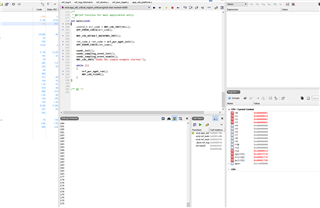

Hello.
I am receiving an input of 1 Hz.
ADC is receiving 12 bits.
uart's baud rate is 1000000.
ADC input is output as UART raw data.
To do this, I modified the following:
#define SAADC_CONFIG_RESOLUTION 2
#define UART_DEFAULT_CONFIG_BAUDRATE 30801920
The following has been modified to do 1.25k sampling (800us).
uint32_t ticks = nrf_drv_timer_us_to_ticks (& m_timer, 800);
It has been confirmed to work normally. (Including source code)

The following contents have been modified to perform 12.5k sampling (80us).
uint32_t ticks = nrf_drv_timer_us_to_ticks(&m_timer, 80);

Please let me know what mistake I made.
Parents Reply
  • I've checked.
    There was a baud rate setting in the main code.
    I thought I had to modify it in the sdk_config.h file, but I need to do it in the main.
    static void uart_init(void)
            .rx_pin_no    = RX_PIN_NUMBER,
            .tx_pin_no    = TX_PIN_NUMBER,
            .use_parity   = false,
    #if defined (UART_PRESENT)
            .baud_rate    = NRF_UART_BAUDRATE_1000000
    #else
            .baud_rate    = NRF_UARTE_BAUDRATE_115200
                           UART_RX_BUF_SIZE,
                           UART_TX_BUF_SIZE,
                           uart_event_handle,
                           APP_IRQ_PRIORITY_LOWEST,
                           err_code);
