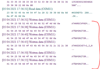

RECVFROM crashes Serial LTE Modem Application
This is very reproducible...after sending and receiving data in a loop, the modem application becomes unresponsive.  Only modification from SDK software is that I am using UART2
The below (note the time) is when the modem becomes unresponsive.  See attached HTML for full log.

<tr class="s1"><td colspan="2">[03/04/2021 20:23:29] Written data (COM18)</td></tr>
<tr class="s1"><td width="5%" /><td><pre>41 54 25 58 4d 4f 4e 49 54 4f 52 0d 0a            AT%XMONITOR..   </pre></td></tr>
<tr class="s1"><td colspan="2">[03/04/2021 20:23:33] Written data (COM18)</td></tr>
<tr class="s1"><td colspan="2">[03/04/2021 20:23:38] Written data (COM18)</td></tr>
<tr class="s1"><td colspan="2">[03/04/2021 20:23:45] Written data (COM18)</td></tr>
<tr class="s1"><td width="5%" /><td><pre>41 54 23 58 53 4f 43 4b 45 54 3d 31 2c 32 2c 30   AT#XSOCKET=1,2,0</pre></td></tr>
<tr class="s1"><td width="5%" /><td><pre>0d 0a                                             ..              </pre></td></tr>
<tr class="s1"><td colspan="2">[03/04/2021 20:23:49] Written data (COM18)</td></tr>
<tr class="s1"><td colspan="2">[03/04/2021 20:23:54] Written data (COM18)</td></tr>
</table>
</body>
</html>
