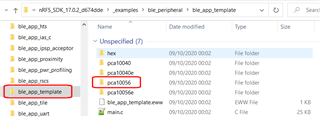

    I've looked at the document, and everything in it has already been implemented. What is missing in many of the examples is the folder for for the dongle, however the same folder is included in some of the examples, illustrating that it can be done.
    What I want to know are the rules for creating such a folder so that I can upgrade existing examples.

    • You could copy just the board folder (and its subfolders) within the example;
    • Or you could copy the entire example folder (and its subfolders).

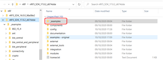

    Or you could copy the entire 'examples' tree:
    Here, you can see that I've renamed it _examples, so that it's easier to find - you could equally copy it and call it "Work" or whatever ...
    The Projects all use relative paths - so, as long as you keep it at the same level in the tree, the actual names are unimportant.

    The template project does not have the pca10059 folder, however the blinky one does - do you think that the blinky pca10059 folder can be used as a defacto for the one missing in the template?
    We have a nRF52840 Dongle Programming Tutorial which should be useful. This describes how to port pca10056 projects to pca10059.
