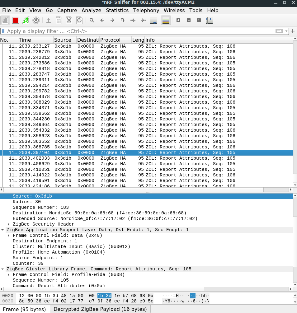

  • so i have the sniffer trace by nordic too but basically, it look something like this
    So when i press the button twice, i can see that reports with the same sequence number (105 and 106) were send repeatedly and if i keep pressing the button consecutively it will crash the MCU. When i make the coordinator online again, everything works fine like this

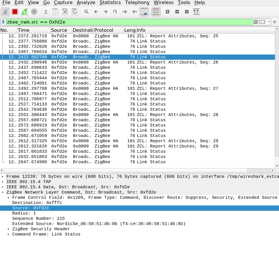

    and i notice that there is a message called link status like this
     It keeps sending every 5s so the problem i wanted to ask is that any way i can ultilize that to detect the coodinator.

    Are you talking about the Link status message or Link Quality request messages? The Link status messages are sent as a broadcast from the coordinator, there is no link quality indicator field in this message.
    These link status messages are used to keep track of route symmetry. All the neighbouring routers keep track of these messages to determine which routers can hear them and which routers they can hear with incoming and outgoing cost.
    I don't think you can get the status of the coordinator network from this message alone.
    From the Zigbee documentation:
    "If a router fails to receive nwkRouterAgeLimit link status messages from a router the neighbor entry is considered stale and may be reused if necessary to make room for a new neighbor."
    But that the entry is considered stale doesn't mean that it gets remove from the neighbor table, so there is no way to know if the coordinator have left the network from reading the routers' current neighbor table.
    What you can try to do is to send a Link Quality request (zdo mgmt_lqi) from the router to the coordinator and ask for the link quality (LQI value).
    If the coordinator is OFF the ZDO Link Quality request will timeout, and then you can assume the coordinator is no longer on the network, but this is the same as principle as trying to send a request for reading attributes or sending a match desc req, if the coordinator doesn't respond the request will time out.

    And by the way, i want to ask another question, is it possible to restrict the number of message resending when the destination is not reachable? if it is, can you guide me.
    The number of retries when the destination is unreachable depends on the number of retries needed on each layer, and these are defined by the Zigbee specification.
    The expected number of retransmissions from the code perspective:
    • MAC: 4 in total (first frame failed + 3 retransmissions)
    • NWK: 4 in total (first frame failed + 3 retransmissions)
    • APS: 3 in total, actually there is a little bug in sdk v4.1.0 here, there should be 4 retransmissions in total (first frame failed + 3 retransmissions) but instead there are 3 transmissions in total, first frame failed + 2 retransmissions.
    This gives around 47-48 expected retransmissions.
    For MAC and NWK layers the minimum number of retransmissions is set to 3 by the specification.
    For the APS layer the only constant specified in the Zigbee specification is the maximum number of retransmissions apscMaxFrameRetries and it doesn't look like there is a minimum value, but it's defined in ZBOSS stack by ZB_N_APS_MAX_FRAME_RETRIES 3. Since this is a ZBOSS compile-time configuration parameter you will need to recompile the whole stack to change this value, which it's only possible if you are a member of the ZOI (Zboss Open Initiative).
    Long story short, no, there is no easy way to "restrict" or decrease the number of retransmissions after the first frame of a message is sent, as this is part of the Zigbee specification.
    If you are worried about latency or bandwidth and you have an enviroment which potentially can get "overflooded" with retries, a good policy could be to keep the packet lenght as short as possible for the given transmission, but to be honest I haven't seen any customers having trouble before because of the packet retry mechanisms of Zigbee.
