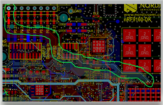

It is shown to be connected on the TRACE connector
so P0.21 to P0.25 and the DBG_CMD going to U1B pin 125 if soldered

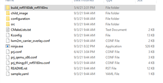

    But where is the overlay file? or does the asset_tracker not have one?
    The asset_tracker files:
    I was imagining I could copy the data from the example overlay file into the asset_tracker overlay file and change the pin numbers appropriately

  • Hi again!
    The asset tracker does not have an overlay file and this must be added. For the nRF9160DK you can create a new file called "nrf9160dk_nrf9160ns.overlay" and add your desired configurations there. This will be included automatically next time you build the application (make sure to reopen the project in SES). Please notify me if you face any issues with this!

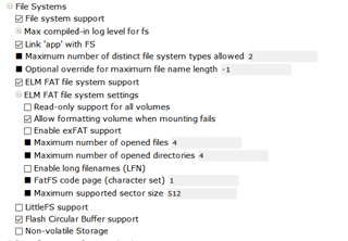

    Prj.conf
    #SDHC
    CONFIG_DISK_ACCESS=y
    CONFIG_LOG=y
    CONFIG_FILE_SYSTEM=y
    CONFIG_FAT_FILESYSTEM_ELM=y
    CONFIG_PRINTK=y
    # SPI
    CONFIG_DISK_ACCESS_SDHC=y
    CONFIG_DISK_ACCESS_SPI_SDHC=y
    CONFIG_SPI=y
    CONFIG_SPI_3=y
    CONFIG_SPI_NRFX_RAM_BUFFER_SIZE=8
    CONFIG_MAIN_STACK_SIZE=4096
    #GPIO
    CONFIG_GPIO=y
    # Segger RTT
    CONFIG_USE_SEGGER_RTT=y
    CONFIG_RTT_CONSOLE=y
    CONFIG_UART_CONSOLE=n
    CONFIG_LOG_BACKEND_RTT=y
    CONFIG_LOG_BACKEND_UART=n

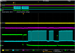

    On the scope, I see the CS and CLK lines moving, but nothing on the MISO or MOSI (I am running the board in 3V mode)
    Could there be something else in the asset_tracker app that is causing a problem for me?
  • Hi Carl,
    It seems to be something to do with the SPI config as if I move the MISO and MOSI to other pins, the same problem is apparent, I never see any activity on them, I have just moved them to 0.23 and 0.24, removed the SDCARD and just watched the lines.
    CLK works,
    CS works
    nothing on MOSI
    I'm pretty sure the init routine should be sending a string of 0xff's via MOSI on startup.
    What could I have missed to stop the signals?

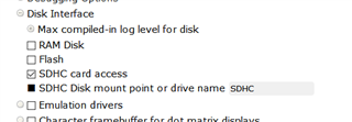

  • Hi again,
    Some additional information.
    I am not sure where the configuration is now supposed to happen, using the menuconfig option or directly in the prj.conf file.
    I tried using the menuconfig to enable log debug for the SDHC driver, but was not successful, the option seems to be ignored, if i manually add
    #define LOG_LEVEL LOG_LEVEL_DBG
    to disk_access_spi_sdhc.c then i get the following output

    Thank you for your patience. Do I understand it correctly that you are using the nRF9160DK? In that case, some GPIO pins have already dedicated functions and should not be used for other means. There is an overview of these on in the infocenter documentation. From this I see that you have been using the pins that are dedicated to the interface MCU and DK board control. Could you try another set of pins instead, for example P0.10, P0.11, P0.12 and P0.13?
    How did you try to enable the debug log in prj.conf? It should be enough to add CONFIG_DISK_LOG_LEVEL_DBG=y.
    Carl Richard
