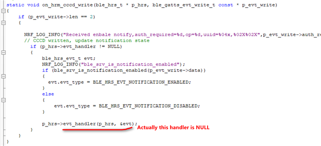

How does ENABLE NOTIFY work on the Peripheral side?
I'm playing the peripheral example hrs.
I find that when it received a enable notify(that is write cccd handle to 01 00) from the central, the code actually doesn't do anything.
So for writing cccd =1 is needed by SoftDevice or not? Which side's softdevice ,central or peripheral ?
If central doesn't write the cccd handle to 1, can peripheral still send the notification by sd_ble_gatts_hvx? can central receive this notification?
