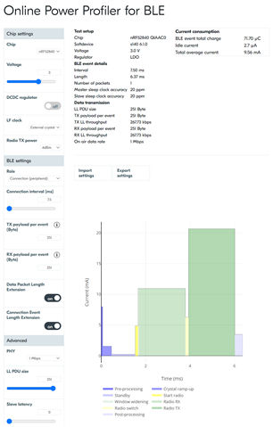

    The softdevice will only enable the radio at the configured connection interval, but it is possible to configure it to send/receive more data to increase the time the radio will be on. This is an example where I reduced the connection interval to 7.5ms, increased the output power to +4dBm, and increased packet lengths to transmit and receive 251 bytes of data every connection interval:
