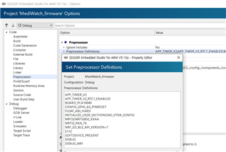

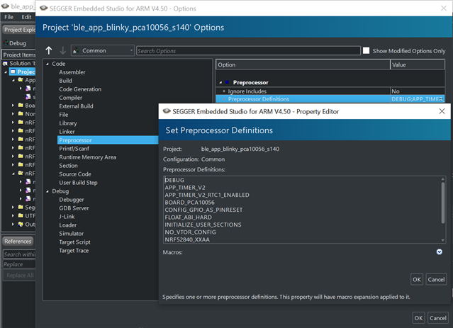

    Please also make sure to have DEBUG defined in your preprocessor defines, like shown in the included image.
    This will print a detailed error message to your logger if a non-NRF_SUCCESS error code is passed to an APP_ERROR_CHECK.

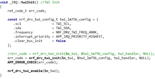

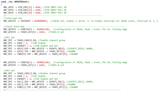

  • Hi
    Thank you for reply.
    Display LCD screen using GFX (ST7735s)
    Designed to recognize screen touch by touching LCD
    GPIOTE recognizes touch on the screen and uses Timer to distinguish touch and slides.
    Receive sensor data for 20 seconds using TWI. (Check twi data using uart.)
    When receiving for 20 seconds, if you touch the screen, the LCD screen stops and data coming through TWI communication stops.
    The reason why twi is used nrf_drv_twi is that the twi data continues to lose in the middle during the ble setting.
    (I don't know why the loss happened, but it's solved after using nrf_drv_twi)
    Timer_Init
    Twi_init(before)                                           twi_init(After)
    Thank you.

    What IRQ priorities are you using for the different interrupts?
    I see from your earlier screenshot that twi is using the highest app priority.
    Have you made any changes to this, and/or is the highest app priority the default value?
    Since the twi already has the highest app priority level, it should not be possible for it to be interrupted by the LCD update. Are you using BLE at the same time?

  • Hi
    I didn't touch twi priority, also I didn't use ble.
    There's something I didn't say by mistake.
    I need to receive sensor data in real time for 20 seconds using twi.
    I have run 2 tests.
    1. The first is to perform LCD update and twi communication in the main at the same time.
    2. The second method is to perform twi communication only in the main, and update the LCD when an interrupt occurs in GPIOTE.
    In the first test, the twi was not cut off, but it was confirmed that the value came in slowly. And then we had a problem that went over 20 seconds.
    In the second test, the value comes in real time, but when GPIOTE Interrupt occurs, sensor data stops coming in briefly or twi communication and lcd stop at the same time.
