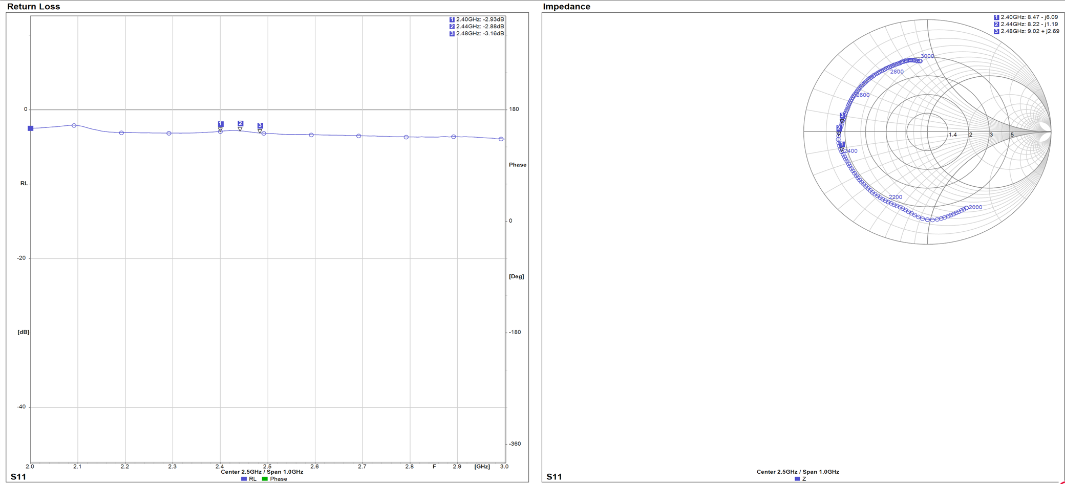

    I reduced L2 from 3.3nH to 3.0nH and C13 from 1.2pF to 1.0pF and the conducted power increased from -1.56dBm to -0.04dBm!! The total radiated power (TIG measured over 3 planes) increased by 1.2dB (2.402GHz), 2.6dB (2.440GHz) and 2.0dB (2.480GHz). The harmonics are well below -50dBc which is good.
    So I'm quiet happy with the result, next I will do receiver sensitivity measurements to make sure Rx mode is not negatively impacted.
    Is there anything else I must keep an eye on before going into approval ?
    One interesting fact:
    Simply looking at the S11 coefficients it doesn't seem obvious that the matching is improved at all but the power measurement clearly shows an improvement (as you said in your reply). Find the comparison of the S11 measurements below. Do you have a logical explanation for this?
    Pin matching comparison
    Best regards
    Rashid
  • Usually good TX means results in RX performance also, and radiated testing will result in differences but you should be in the right ballpark now that the conducted measurements are done.
    I don't have a logical explanation for the graphs other then that you can see a difference but that's why we measure harmonics and power output, it is the best indicator and easier to see improvements.
