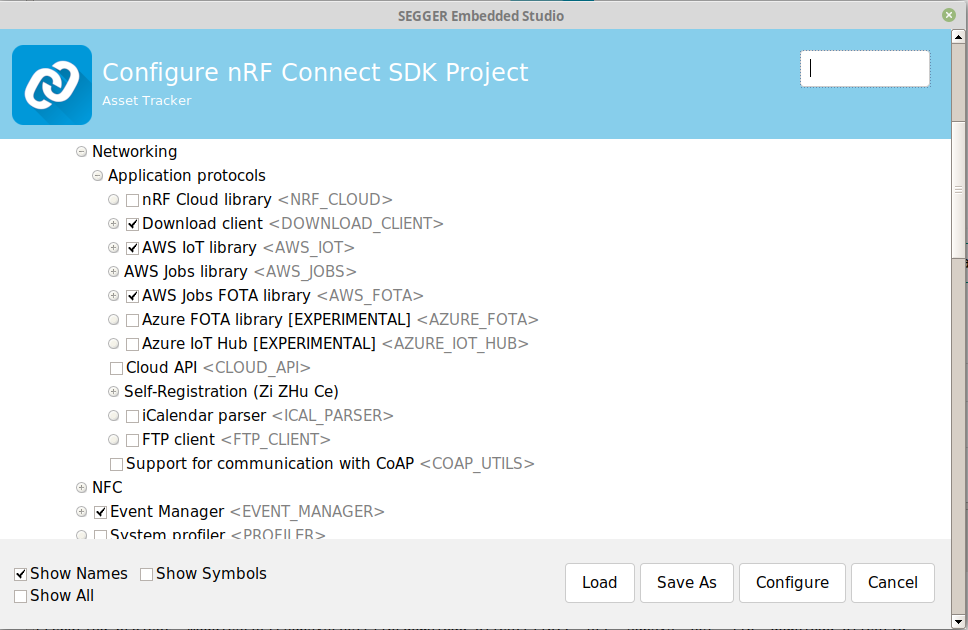

Would you be able to clarify why the Azure IoT hub is marked as experimental in NCS v1.5.0 on the menuconfig?
And is there any features missing or not verified etc?
And if there is a timeline when the library will be cleared of experimental tag?

Can you describe where you find this information, and provide some screenshots? There is no mention of "experimental" in Kconfig.
Hi Hakon,
See screenshot below using nrf v1.5.0 and asset_tracker_v2 as the application
It seems to be defined in nrf/subsys/net/lib/azure_iot_hub/Kconfig and nrf/subsys/net/lib/azure_fota/Kconfig
According to the developer, the experimental tag is due to lack of adequate testing before release. There are no major bugs related to the azure IoT library that have been reported, so it can likely be removed next release.
