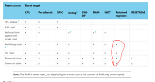

  • Hi Roi,
    Good to hear that you found my reply helpful Slight smile
    The POWER[].RAM registers are retained. So as you can see from the table below, you will need a reset from  either a WD timeout, resetpin, brownout, or "power on" for the RAM power settings set by the application to become reset. This is why a Soft reset (NVIC_SystemReset) will not recover the device in this particular case.
    Roiger said:
    but we want to know the behavior for unplanned resets.
    You can change the RAM power settings before calling NVIC_SystemReset() from your fault/error handlers as well. The only challenge is that you must write directly to the memory protected POWER registers as the Softdevice APIs may not be available from the error handler. Please see this post: https://devzone.nordicsemi.com/f/nordic-q-a/53248/disable-softdevice-sandboxing-in-fault-handler. The only difference is that you want to disable protection of the POWER module, not the NVMC.
    Disabling MWU sandboxing of POWER:
    NRF_MWU->PREGION[0].SUBS &= ~(MWU_PREGION_SUBS_SR0_Include << MWU_PREGION_SUBS_SR0_Pos);
    __DSB();
    Regards
    Vidar
