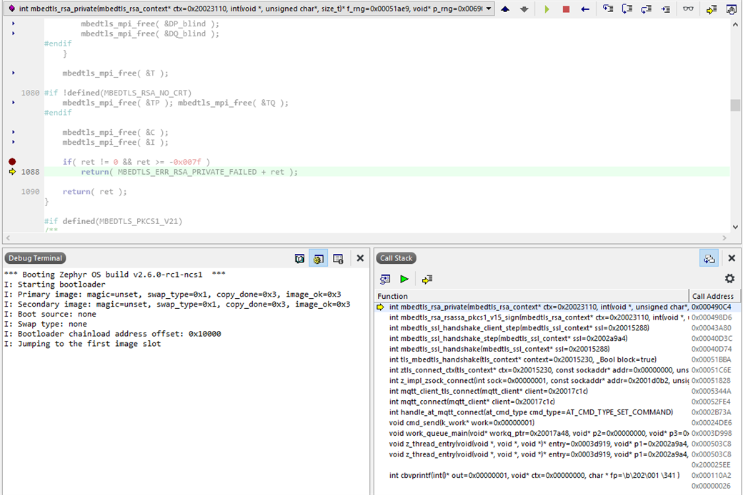

    Understood. I will check that out. In the meantime I have found what looks like the point where my error first arises in rsa.c. You can see the Call stack and the line where the error code comes from in this image.
    Watch on "ret" doesn't work here but I do believe the value is -0x10 = MBEDTLS_ERR_MPI_ALLOC_FAILED.
    Hopefully that might be of use in the future.
    As a side note it's pretty difficult to step through this code because it is optimized and there is only Common Configuration in the drop down. Is it possible to run this SLM application in an unoptimized Debug configuration?

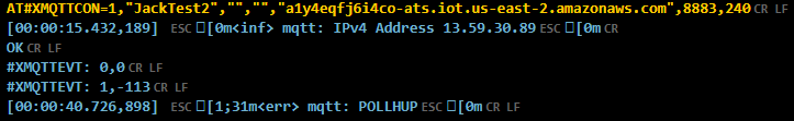

  • I was able to get past the handshake by increasing the CONFIG_MBEDTLS_HEAP_SIZE. In my case to 81920.
    Now the error is POLLHUP. From what I can tell at this moment this occurs immediately, the first time the socket is polled.
