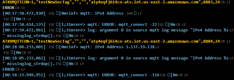

  • Thank you Didrik.
    I think I misunderstood the mapping, however, I have tried using the Native TLS version to write the credentials and I could not connect to my Broker. It is possible that I did not format the creds correctly.
    So I took the mapping knowledge and I used a non-native TLS App to write the creds to SecTag = 240.
    I reloaded the NativeTLS application and I do read my type 0 credential with AT%CMNG=2,24,0.
    However It still is not connecting. Interestingly I get this output. The first time I am using the correct port and the second time I used an incorrect port and got different output.
    I tried again this time incrementing the SEC_TAG (per the mapping function) when I use the modem_key_mgmt_write function in a non-native TLS app.
