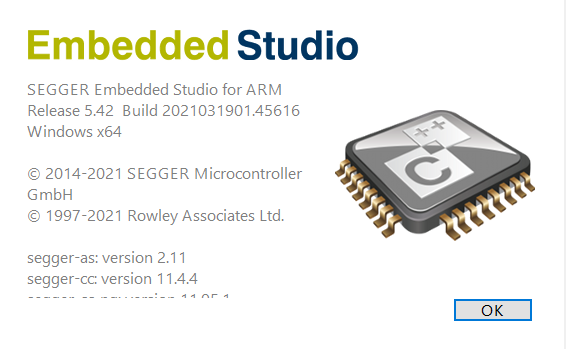

I installed the SES and opened the simplest (blinky) solution from the nRF5_SDK_for_Thread_and_Zigbee_v4.1.0_32ce5f8.

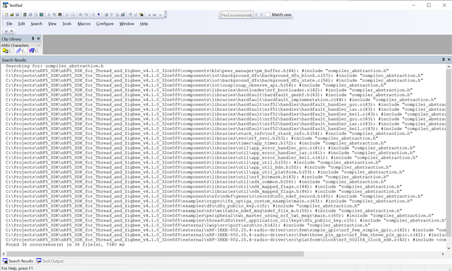

Compiling failed as the "compiler_abstraction.h" could not be found.
I downloaded the nRF5_SDK_17.0.2_d674dde, opened the same solution there and ran a successful compilation.

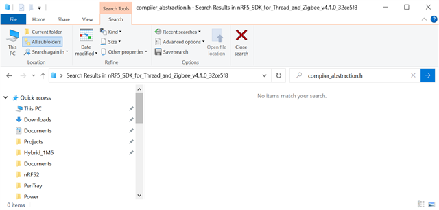

A search shows that the file "compiler_abstraction.h" does not exist in the nRF5_SDK_for_Thread_and_Zigbee_v4.1.0_32ce5f8.
However, it exists in both nRF5_SDK_for_Thread_and_Zigbee_v1.0.0 and nRF5_SDK_for_Thread_and_Zigbee_v3.2.0_9fade31 and
I am able to complile the blinky examples in these older SDKs.
