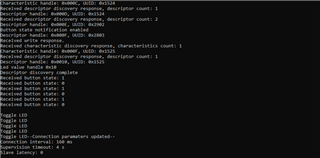

Modify pc-ble-driver example for Nordic UART Service
I try to modify one of the pc-ble-driver examples to work together with my PCA10040 and the Nordic UART Service example in my Qt application, but the application doesn´t discover two characteristics and receive an event with the ID 0x23 and 0x12:
Open softdevice...
Log:  2 - Successfully opened COM5. Baud rate: 1000000. Flow control: none. Parity: none.
Status:  6 - Target Reset performed
Status:  7 - Connection active
Enable softdevice...
Start scanning...
Scan started
Received advertisement report with device address:  0x453e4ff9a8
Connection established
Discovering primary service
Received an unhandled event with ID: 0x 23
Received service discovery response
Found  1  services
Discovered service with UUID: 0x 1 , start handle: 0x ffff , end handle: 0x ffff
Discovering characteristics
Received characteristic discovery response, characteristics count:  1
Characteristic handle: 0x c , UUID: 0x 2
Discovering characteristic's descriptors
No characteristic handle found
Received an unhandled event with ID: 0x 12
Disconnected, reason: 0x 22
How do I have to modify the code to use both characteristics of the service?
