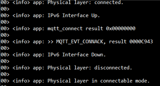

but from the device I get an error:

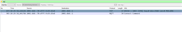

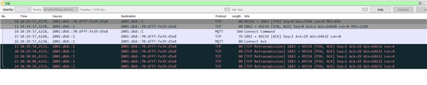

I am using tshark to check Raspberry Pi's incoming and outcoming packets and a sniffer to check the connection on air and it seems like TCP packets from the Raspberry Pi are not getting to air.
I'll attach the full captures, but what the sniffer sees is this:
and packets from the Raspberry Pi are seen like this:
